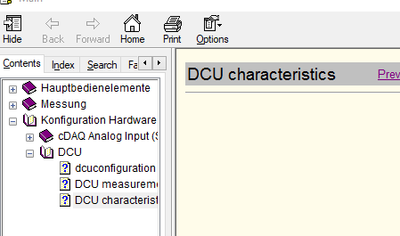

actually I "try" to create a documentation for my software-tool with a *.chm-file (standard help-file).
I want, that the user can jump directly to the correct position in the content-tree like in the picture attached (not index-register).
First try with "Control online help.vi" doesn`t work respectively I use it in the wrong way.
So my question: is it possible with Labview to open a entry in the content-tree?
Thanks!!!

Thanks wiebe,
I use the only simple freeware-tool I found named Helpmaker. Its not supported since years.
I found the Url´s in the CHM-file and the correct side will open. But the content-tree will not expand...Do you have an idea, how this works?

Thats exact what I´m looking for...but when I start the att. vi...only the correct right page will load, not the tree...
