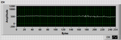

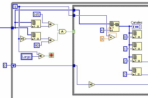

I capture the data stream via serial port using VISA, then i search the sync bytes and split the values in 4 arrays for the CH1_HI and LO and CH2_HI and LO bytes as you see in the following images:
 I would like to get the HI and LO values of each channel array and display them in two chart graphs showing all the 255 values in each second.
I have tried but the search and graph process takes too long, how can i fix it?

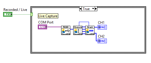

I have been working on this project and since then i haven´t checked this thread. Thank you for your response, but in the end i solve it like this:
Tree stages: read stream, divide channels and graph.

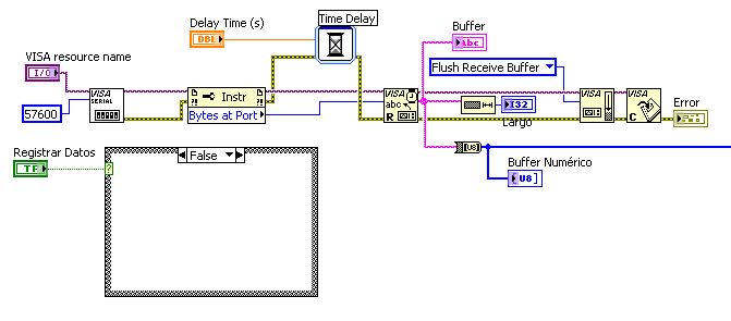

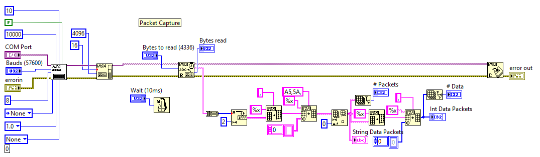

Inthe Read VI i got it like this:
2014-01-13 12_46_55-OpenEEG_Read.vi Block Diagram on OpenEEG.lvproj_My Computer.png

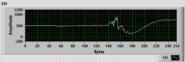

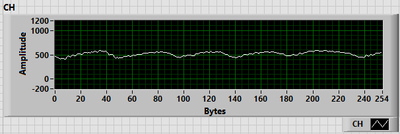

So in the end the Graph VI gets me somthing like this:
2014-01-13 12_48_37-EEGSerial_V4.vi Front Panel on OpenEEG.lvproj_My Computer.png
Eyebrow movement waveform depicted in the graphic, just like our friend The Rock is showing us:

For instance, if you want to control a device using only your facial movements, lets say: blinking, eyebrow raising, jaw clenching, eye left/right movement, blinking, and eye winking.
Each one of them has a different waveform:
eyebrow raising:
jaw clench:
blinking:
So, i would like to know how can i get to recognize this waveforms out from noise or other stuff detected by the electrodes?
I would appreciate your help!

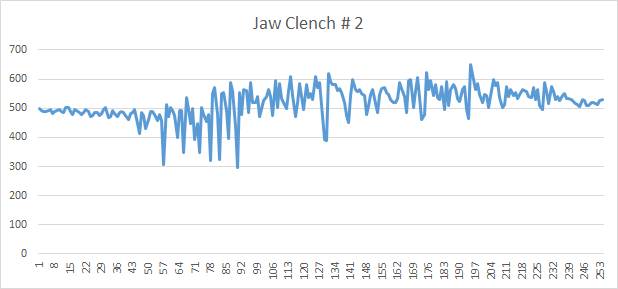

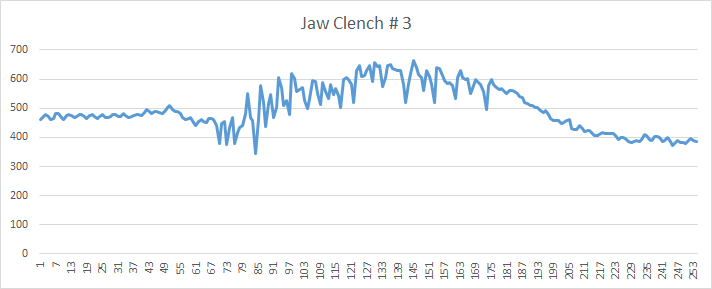

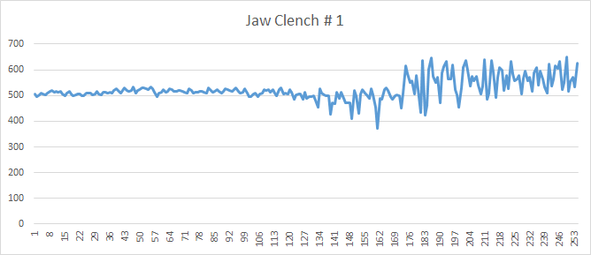

The data is a 1D int array, with 254 data samples between 0 to 1024, then is saved into a CSV file for later anaysis and signal recognition.
I attach a CSV file with a jaw clenching signal that you can graph by using any spreadsheet software.
As an example this is how does it look 3 jaw clenching signals which needs to be recognized.
Message 6 of 18
(7,656 Views)
Hello gustux,
I suggest you to have an average waveform so that you can use it as a template or as your main waveform reference for each facial move (Jaw Clench, Eyebrow Rising, etc). Then what you can do is every time you acquire a waveform perform an 1D array subtraction between the waveform reference and the acquired waveform, after that you can compare each array value and determine if the difference is big enough to be a Jaw Clinch, Eyebrow Rising etc. That could be one idea on how to tackle the problem; just make sure to have good acquisition hardware and a reference value in order to start capturing any facial move in order to avoid phase shifts between both waveforms.
