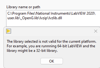

So I manually change the absolute path to the dll like and I get this prompt:

I download this file, rename the original to lvziplib_32.dll and lvziplib64.dll to lvziplib.dll and mass compile again
still a broken white arrow
when I manually change the absolute dll path to 64 version, the vi is no more broken
do I have to do this manually for all calls of the dll node in the toolkit?

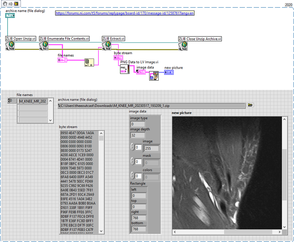

so, I copy https://github.com/Open-G/lvzip-library extract the folder source\lvzip.llb and change every path in every clf node which is in lvzip.llb manually to an absolute path ending with "C:\....\lvzip64.dll"
there is also a very compact but very well demo hidden inside "ZLIB VI Tree.vi" on how to use the vis in the .llb
and it works! My first test is to extract a PNG from within a zip as a byte stream - conveniently, the "PNG Data to LV image" works out of the box
