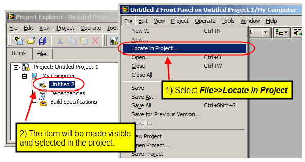

Hello Everyone,
There is a new
OpenG tool called  "File Locate in Project" library (ogedit_file_locate_in_project) available.  This package adds a File>>Locate in Project option to the LabVIEW menu.
When you select this menu option from the menu of a VI's Front Panel or Block Diagram, the VI will be highlighted in the Project Explorer window.
See here for more info.
