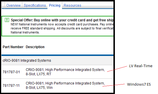

That question is too generic. What do you need to know exactly?
cRIO-9081 and 9082 are the high performance controller+chassi, and can be used with WES7 (not Real-Time) OR LV Real-Time OS.  The hardware can be used with any of these options (not both at a time) depending on what kind of application are you thinking of.
https://www.ni.com/en-us/support/model.crio-9081.html
(4,890 Views)
Thank you very much,
You have clarified my doubt.
(4,887 Views)
