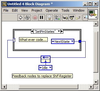

On a different note, you may know that already but when you move your subVI loop at the top level you don't necessarily need to move the shift register to the top level as well. You can use local shift registers as shown on this concept diagram.

Yes, you are right! Of course I want my SubVIs to be reentrant! 🙂 I got confused here.
I used local shift registers to initialize my signals but I was not sure if that really works. So thanks for reaffirming me that this is the correct way to do this! 🙂
