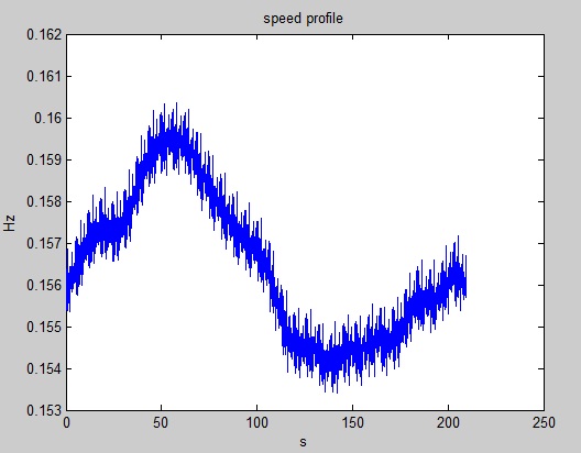

When I want to perform order analysis in LV I need to have tacho signal. I understand it that I need some "TTL" signal where is one pulse per revolution. ____|-|_______|-|___|-|_______ The period depends on the rotating speed. This signal is transformed in LV to even-angle signal and output is speed profile signal which go to OA blok.
However I my case I do not have TTL signal from tacho but rotating speed signal in Hz and coresponding time values.
 I know that rotating speed is about 0.1 - 0.2 Hz. I have 200 secunds of signal with 4000 samples of rot. speed in Hz and coresponding time values. I want to do the speed profile cluster which contains time array and RPM array. My idea is just take the time values and rot. speed in Hz multiplied by 60 to get RPM.
However I am not sure about this. The results from OA seems to me not to be correct. Does some do something like this ?

Hi Charlie,
Even the frequency f in Hertz seems to has the same unit [1/s] as the angular speed (omega) [rad/s] or just [1/s] , remember the relation:
omega=2*Pi*f,
and the relation between angular speed and RPMs
RPM=omega*60/(2*PI)
so, as you stated in your post, RPM = f * 60, this should be correct.
What do you mean, that the analysis doesn't seem to be correct? I'm not really sure what's the problem about. What is the target of analysis?
Thanks for explaining. Have a nice day

I did a small research with the example VI from S&V library and also I found in  NI page that  "speed profile specifies the arrival time and the rotational speed of each tachometer pulse". I understand that every pulse (e.g. one per revolution) I get one speed value in RPM. However my signal have definitely more then one pulse (sample) per revolution. I suppose acc. to this page that an encoder is used because the rotation speed is very slow. The point is that I do not know nothing about the encoder ( how many pulses per rev) and how to transform the signal to be correct for speed profile or whether does any VI exist to use this kind of speed signal to produce order analysis.
