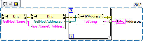

Pretty sure to resolve this you need to use .NET.
Here's one way, though it's not perfect as it returns IPv6 addresses and the rest are returned in no particular order, so you'll have to filter the ones on subnets you don't want:
Can you elaborate how this solves the OPs problem? With the String to IP node in Array mode you also get a list of (exclusively IPv4) IP addresses and have to then sort that to find your right adapter. The order in which the network adapter adresses are returned is determined by Windows and based on some internal sort criteria. In theory the primary adapter used to be always the first, but that changed in recent Windows versions based on something else.
