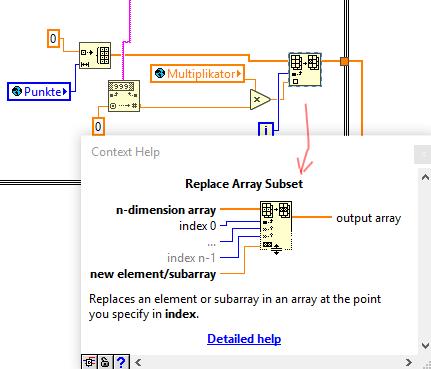

The function “Replace Array Subset” will replace elements of the array at the point that you specify it.
(Picture attached)

Hi James and surknival,
ReplaceArrayElements is perfectly fine - once the array is defined before the loop and kept in a shift register!
(Right now the array is initialized inside the loop in each iteration…)
Instead of InsertIntoArray you should also use BuildArray to append/prepend elements to an array!
