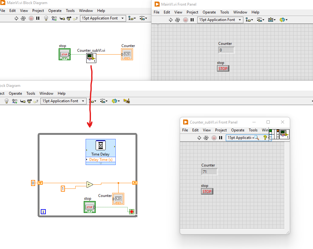

So I have a problem which apparently doesn't really have a solution (or at least I couldn't really find one). Here's the deal:
I have a subVI which just increases a counter at a given time interval, inside a while loop. This loop has a stop button. When tested separately the counter updates correctly and the stop button works fine. Now, let's take the counter and the stop button, route them as terminals and put everything into a subVI. When using the subVI neither the counter is updated, nor the stop button works.
How to solve this? I want the value from the counter from the subVI to propagate to the main VI. I also want the stop button to work from the main VI.
Please note that this is a very oversimplified example. I reality I have an event driven communication protocol and therefore needs to be inside of a loop (in order to wait for the event to occur) and then output the data from the transmission (via a terminal, because it all needs to be implemented inside a subVI to be used later). But I feel if I have the solution to the simplified example, it will also work for the more complex scenario.
subVI and main VI attached.
Thank you in advance for any suggestions!
Ray

At this moment your sub-vi receive either a True or False from your main and either insta-kill the subvi or perma-block it.

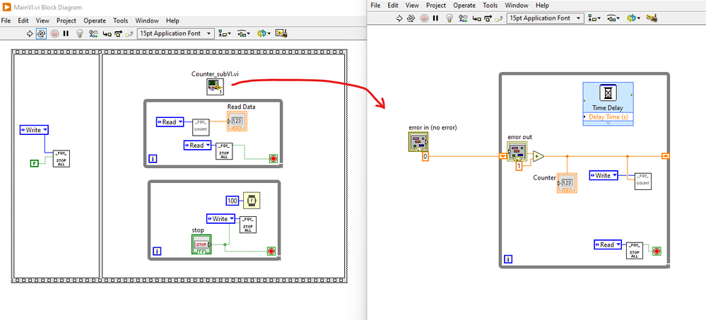

Hello Defaphe and thank you!
Functional global variables were indeed a good solution. To anyone else wondering, here's how the final solution looks like:
You can learn more about FGV here.

Thank Mark and everybody else for the replies!
I did end up using queues (once I figured out how to correctly design the loops in parallel) and it works indeed better than FGV.
However, I still have a problem with the Stop button to stop all activity. For that a queue is not suitable )I would "push" only one element (when the button is pressed), but would to "pop" several to stop multiple loops). Notifications don't work because the "Wait on notification" action pauses the loops until a notification arrives. I'm looking into somehow creating a "custom" event when the button is pressed and then having multiple event structures that all trigger on the same custom event. Would that work?
