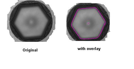

I am having an image that goes through several stages. At one stage an overlay is created on the image. But this image with overlay is not saved anywhere. My question now is: Is there a way to find the coordinates of the centroid (x) in the image with overlay ?Since I am not saving the file i cannot use IMAQ Read image & vision info vi.( correct me if i am wrong)
Any better ideas to deal with it?

Do you want the centroid of the overlay or the centroid of the image?
If the centroid of the image why not just use the Image Size then work it out from the x,y coordinates.
If the centroid of the overlay, how are you creating the overlay? If you are creating it from an ROI, you could work it out from the global rectangle of the ROI.

@ Phil_ : I want to have the centroid of the overlay. I looked trying to find how  the overlay is created. All of the overlay creation steps are done inside a dll. I was not able to find any ROI in it. And i am not  supposed to reveal the dll due to privacy problms.
@Hooovahh: I do not want to save the image with overlay. I just need to use the image with overlay to find the centroid.

So this isn't an Imaq overlay, this is an overlay drawn with your own dll?
I assume that means that your original image will be greyscale, and your image with overlay will be RGB?
If the overlay is always the same colour maybe you can isolate the overlay using the colour information somehow and work out its centroid from there?
