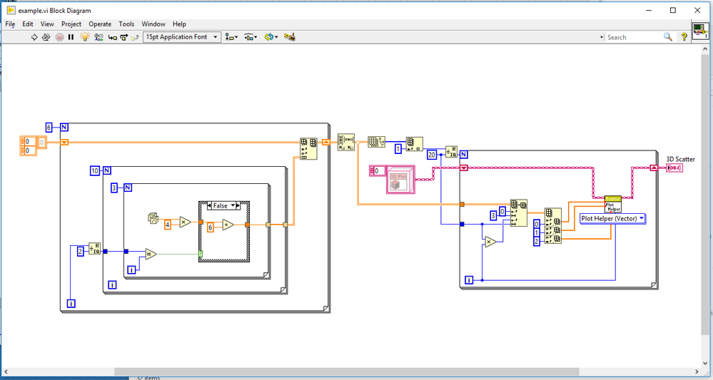

I will attach here the sample VI used in my last reply.

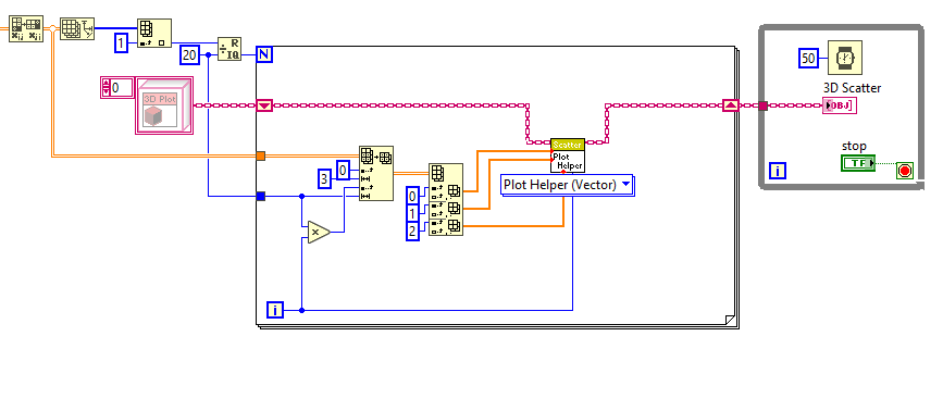

I only have LabVIEW 18.
I attached what I coded.

Compare your VI to the one Didash attached.  See if you can find any differences.  They may be subtle.
Spoiler
Look specifically at the Index Array function of the final For Loop and which indices he attached his constants to versus the ones you attached your constants to.  Actually, he did not need to attach any of those constants, it would have worked the same way without them.  With yours, if it was otherwise working for you, you want not have needed to attach the 1 or 2 constants.  Index array defaults to 0 for the first index if unwired, and increments according 1, 2, 3, ... for the indices of the following outputs if unwired.

Didash put a picture of his VI in his mess as well.
If you created your VI by copying his picture, then you did a remarkably good job as your VI looks ALMOST identical to his.  With the exception of the thing I pointed out.
Go back and compare his picture in messages 4 and 8 and compare with yours in message 12.

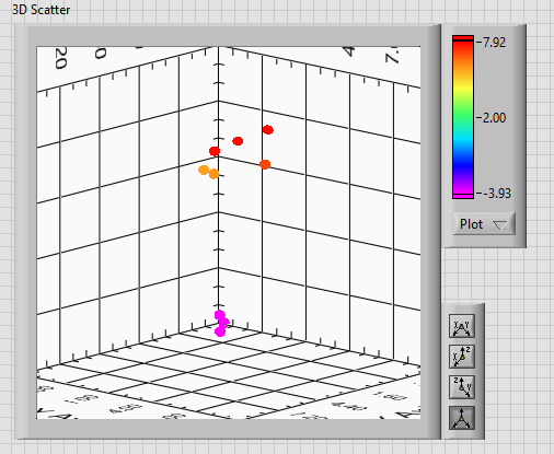

My original code did not transpose so I had the x y z connected.  my bad eyes.
But the plot seems not colored correctly

I pointed out two ways to assign colors to plots in the previous messages. Manually or programmatically.
To do it manually you can assign a color to each plot by right clicking on the graph, going to the 3D Plot Propperties, and in the Scatter category you can custom the Color Ramp for each plot. Select the option "None" to assign a single color to the plot and then change it to the color of your preference.
For a programmatically way of assigning colors to plots you can check message 5.

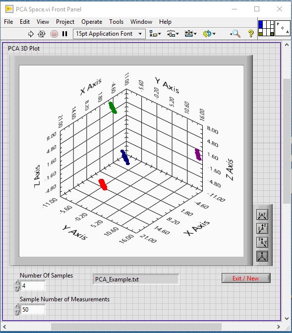

I have 4 items and make 50 measurements of each it.  I use the AML toolkit to perform PCA and then using the latest discussion I can create my plot.
I think I'm well on my way with my project.
Thanks again for the help.
