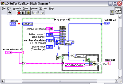

I am getting an error -10403, which gives a possible reason of:
NI-DAQ LV:  The specified device does not support the requested action (the driver recognizes the device, but the action is inappropriate for the device).
Any ideas what might cause this?
The error comes from a library call to AO_Buffer_ConfigInterface, shown in the screenshot below:
This is using the lvdaq.dll

Is this code that's been recently developed or modified?  Or are you suddenly getting a new error from long-existing code?
Have you tried implementing the same kind of AO task under DAQmx?
As a very-slightly-educated guess, I'd be looking at the 'allocate mode' input first (what does the value 2 mean?).  I'm not certain what the 'number of updates' means either, but am suspecting it might be a total # samples to generate?
Sorry, it's been a loooooong time since I used traditional NI-DAQ, and even then I didn't do much AO.
-Kevin P
