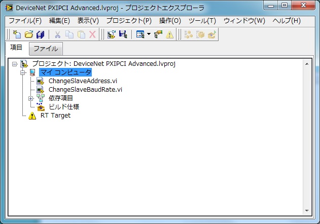

3) I was started the "DeviceNet PXIPCI Advanced.lvproj" .
  *I attach the screen copy.

Hi adasan,
The project below looks correct. I would check the error with hardware removed and get a technical report. We can go from there.
