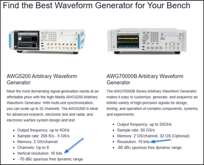

The PCIe-6738 uses a 16-bit DAC. A 24-bit DAC could theoretically achieve a resolution that is 256 times better than a 16-bit DAC, which would mean a theoretical resolution of around 1.2 µV over a ±10 Volts range. After a quick online search, I wasn't able to find a NI PCI or PCIe card that uses a 24-bit DAC. For example, the more expensive PCIe-7852 also uses a 16 bit DAC.
It seems that even powerful bench-top Arbitrary Waveform Generators from other manufacturers, such as Tektronix, don't offer 24 bits.
