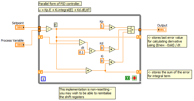

I don't have the control design / PID toolkits installed at the moment as I rarely use them nowadays but when I last did it, I ended up implementing my own. This should be a good starting point:
It is about as basic of a parallel PID implementation as I can come up with (for Windows - hence the doubles, if on the FPGA you'll probably be using floats). You may wish to extend to allow the controller to reset (as per the LabVIEW implementation by reinitialising the shift registers).
I've attached the VI (LV2012).
(blog)
Message 6 of 12
(10,739 Views)

This is the Function of PID i agree, infact i am also using this same logic(with feedback node, instead of shift register, wiith SP,Output and PV inside the while loop and surely not giving a true constant to the stop button Smiley Tongue ) for windows, in the case of Fpga and Periodic waveform input I didnt find this as a good option.

Yes - it is supposed to be a True constant to the stop button so that it executes only once before exiting. The VI I have provided is designed to be run as a SubVI at the point in your main control loop where you want your controller output to be generated.
The reason for the while loop is to allow the use of the uninitialised shift register (which has the same as a feedback node) to store the old error value and the integrated error.
Why was it not a good option? What problems are you having implementing your controller on the FPGA?
