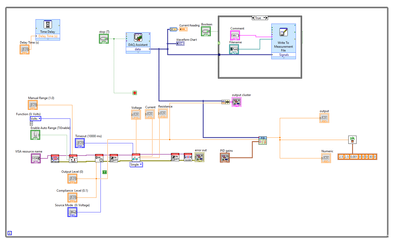

Hello
I connected to PID controller but there is smth wrong. (picture below)
The main idea of program is when we apply 2,8 V to heating element,  temperature of heating element should increase 130 degree.
If T> 130 degree
Power supplier = off
else T < 130 degree
Power supplier = on
or I can control it without PID ?
(2,789 Views)
Hi Dudoni,
If T> 130 degree
else T < 130 degree
Power supplier = on
Why do you need a PID for such a simple ON/off approach???
Why do you need to initialize the Keithley in each iteration?
Why do you need to close the Keithley communication in each iteration?
Why do you need to switch the Keithley on/off in each iteration???
Why do you connect the Keithley output to the PID pv input?
Why do you work with DDT wires and why do you connect that DDT wire to the PID sp input? Do you notice that coercion dot?
What is the purpose of that "plant" subVI?
Did you determine meaningful PID gains?
(2,784 Views)
