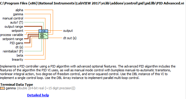

I also can't identify the problem. Actually, the error shows for "PID Advanced.vi and PID Advanced autotuning.vi" only. other vi are ok. the connector pane is also ok. I have attached picture for clearing this matter.
Is there any other way without using this (PID Advanced) option?

Hi Milon,
now you have shown the connector pane of the "DBL Array" type of the PID function.
As this is a polymorphic VI you also need to check the "DBL" variant of that PID function!
As the error said: "one of the polymorphic versions has a different connector pane and so the whole polymorphic VI is broken"…
