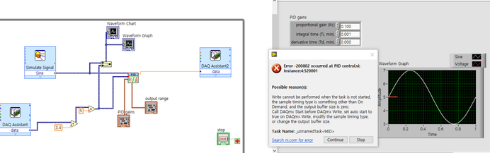

Hello, I am building a very simple PID for positioning control in the mechanical system driver by a piezoelectric actuator. The setpoint should be the 1Vsin(1Hz)+5V so the sine wave. For the process variable, it receives a signal from the capacitive displacement sensor. But I am having keeping error in DAQ assistant 2 for analog output. I set as a continuous sample and it kept giving me error 200802. I am so lost and I don't know even what it is saying... since I am new to LabVIEW. Could someone please help me to figure out this? I am using NI USB-6351 for the hardware.

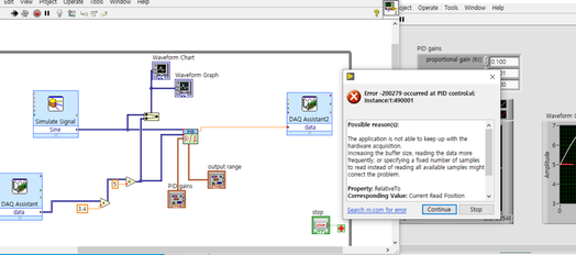

Also when I hit continue it shows an error in DAQ assistant 1 (process variable) showed different error.

So you used some wrong settings in those ExpressVIs. As you decided not to provide your code, but just images of some code parts, you need to debug on your own!

You are using ExpressVIs… 🙂
Other errors:
You are using wrong/unreasonable settings in your ExpressVIs.
You ignore the coercion dots at the PID function.
You are using default PID gains…
Again I recommend to replace the ExpressVIs by plain DAQmx functions!
(Until then you should use "1 sample on demand" for AI and AO and add a timing function to your loop…)
