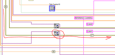

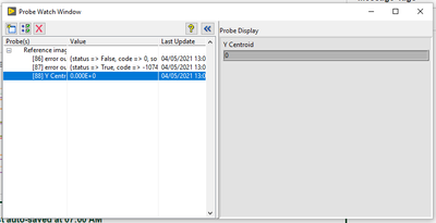

Ok i think i may have found the error for this.
When the code passes through both of these nodes there is no error, when the data passes through node 86 for the second time no error occurs. I then pass through the IMAQdx configure grab vi I then get the error. The error applies for all 3 cameras
How can I fix this, see the image attached.

You don't even mention the error code you get and it is not fully visible in the probe window. My guess would be that the Grab VI can not start since there is still a grab active for that session.

The error code is this:
Error -1074360311 occurred at IMAQdx Open Camera.vi
Possible reason(s):
Camera not found
despite a camera session being open.
