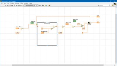

I'm trying to create a LabVIEW subVI, which simulate level of a water tank.
(the SimulateInlet's range is between 0-100, which will increase the level of tank if Inlet's value is true; the ControlValve's range is between 0-100, which will decrease the level)

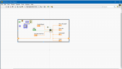

The subVI above is used inside a while loop in main VI, and execute every 3 seconds:

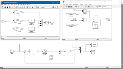

Also, I have tried to use Matlab Simulink, like this:
I think this is supposed to be exactly the same with my LabVIEW and C project, if I set the sample rate of MATLAB Simulink 3 seconds.

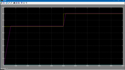

Then, in order to find Kp, Ki, Kd using Zieggler Nichols, I set the Kp=50, Ki=0, Kd=0, but the result looks like this, while I want it to be a sinusoid respond, right?

Actually I have tried to use Ziegler-Nichols to calculate gains for my PID controller in MATLAB Simulink (I mentioned it in the comment, sorry for not being clear). But when I set Ki=0 and Kd=0, and adjust Kp, the respond always shows a straight line instead of a sinusoids (may be my plant is not correct).
