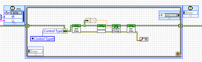

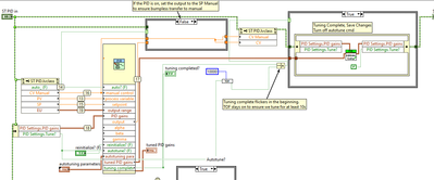

I'm trying to make a simple class to use PIDs with our existing system. It seems that the clones are randomly switching between the class instances which causes the PID to jump of course. It didn't seem to matter if the VI is setup for preallocated clones or shared. The Run.VI has a loop to get data from the larger system, run the PID VI, then write data back to the system. The PID works great if only one is on at a time or if I use one for "PID Advanced Auto Tuning" and the other on "PID Auto Tuning (Temperature)". But ultimately I want to have 5 PIDs running in parallel so I want to solve this clone issue. Previous posts from 2014 suggest launching the clones as asynchronous will call and collect but I'm not sure that is applicable in this situation. My background is in PLCs so maybe I'm just using Labview's PIDs completely wrong. I've also failed to get the auto tune feature to spit out anything useful.
Why would the class instance not use the dedicated clone when it's preallocated?  I'm not sure how to work around this issue besides making absolutely everything "in-line", which sounds obnoxious.

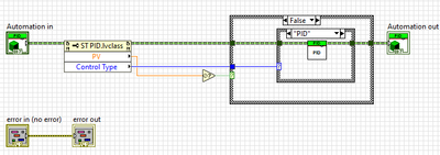

Everything is a clone besides the main VI that calls the loop I posted. That loop is a shared clone, part of the PID class. The PID itself seems stateful, since it's calculating error and change in error. I assumed the VIs would always use the same clone instances, but they are randomly swapping, which is confusing.
I think I posted all relevant code. I didn't want to weight it down with all the dependencies, but here you go.

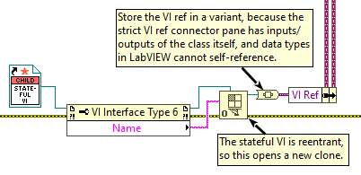

Open and store a clone of the stateful VI in your class data:

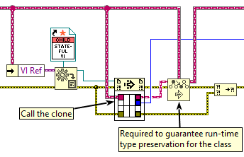

Call the VI clone during your process:

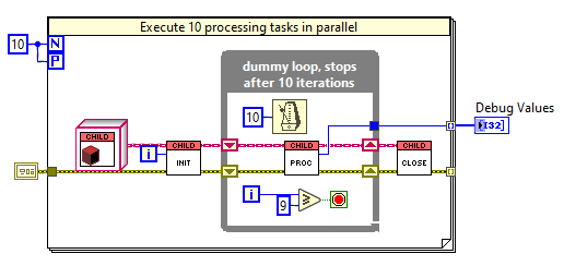

Attached is an example where I execute 10 "processing tasks" in parallel based on a simple class hierarchy ("Base" and "Child" classes).
Each class has "Init", "Process" and "Close" dynamic dispatch methods. "Init" opens and stores the stateful VI clone, "Process" calls it and "Close" closes it:
In my example, the stateful VI just adds its instance index ("i" in the main loop) repeatedly to a feedback node and outputs the result as "Debug Value". So, instance 0 does 0+0+0+0+..., instance 1 does 1+1+1+1+..., ... 10 times in total. In the end, you get:
If you toggle the Diagram Disable Structure in the Process VI, you will have your current implementation (statically calling the stateful VI). Here you can see that the data are randomly mixed up:
Raphaël.
