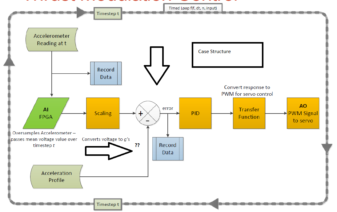

I am making a Labview VI that control's servo, by comparing onboard acclerometer readings.  A set profile(in excel) will be used and compared against an onboard acclerometer's z-axis reading's.  When the acclerometer reading's are above or below the expected value the servo will get a signal to adjust manually, this will be done by a Case structure.
My question is about comparing the reading's.  Can anyone point out how can I get labview to compare excel readings against onboard readings?
The image below shows a block diagram of what I am trying to obtain.  The end result is to try and alter thrust on board a rocket.  We will be using a Myrio which was donated for this project.
Any advice is much appriciated!

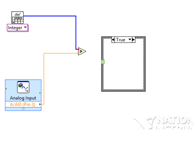

I understand I currently don't have the excel data on me, but I am just experimenting with the code.
But anytime I add a comparator it won't hook up with a case structure.

Hey cwatts26,
That's because in the above screenshot you are comparing an array of values to a single value, which produces an array of booleans as a result. A case structure cannot have an array as an input to it's "?" terminal. You can add a For Loop to auto-index and compare the Excel values one at a time, or you can index the resultant boolean array to get the individual results which can be used with a case structure.

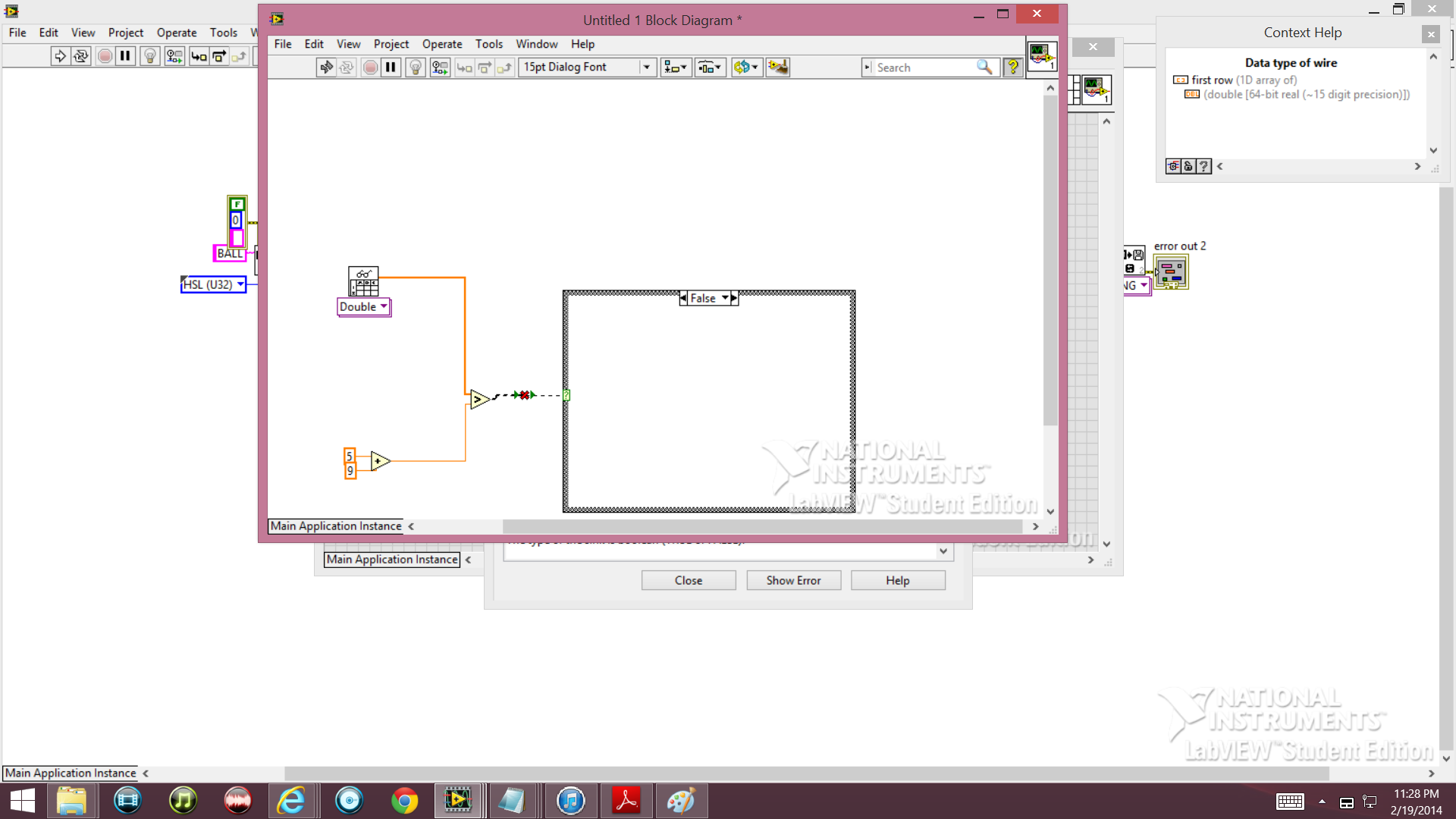

Ultimately I will be comparing an input to a spreadsheet file.  Is a for Loop the best way to do this?
I would like something similar as shown below, but it should be important to note that in the end the input is adjusted for cailberating of a acclerometer.

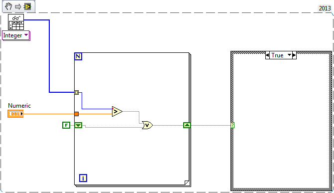

Are you trying to compare the analog value AI0 to every value in the spreasheet by looking to see if AI0 is greater than all of the values in the spreadsheet? Essentially, do want code that generates a FALSE if all the values in the spreadsheet are less than the AI0, but generates a TRUE if only one is greater? If so, here's how I would acheive that:

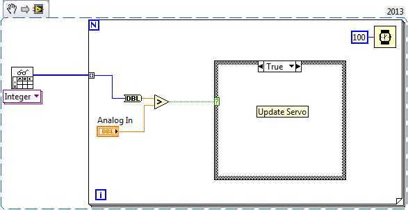

Based on your updated description, I think that this may be what you are looking for. The For Loop reads data from the Excel sheet one at a time because of the Auto-Indexing Tunnel. It is then compared to the current Analog value (just replace my Analog In with your DAQ Assistant Express VI). Based on whether or not it is FALSE or not, the servo will or won't be updated. The Wait (ms) function in the corner controls how fast the values are compared and the servo gets updated since it pauses each loop interation for the displayed period of time in milliseconds.
