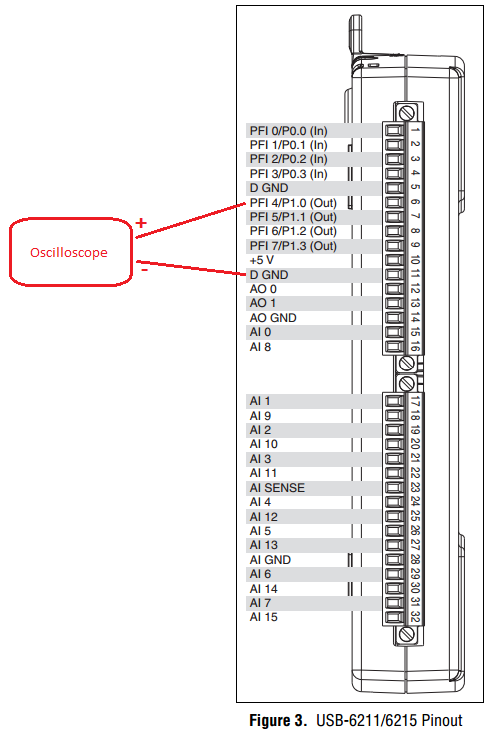

Cant seem to make it work. Didnt get any signal out when link the PFI4 terminal to an oscilloscope.
I am not sure wheather my coding is wrong or my wiring (i.e. from USB 6211 to DC motor) is wrong. I need to use the counter terminal as I have used the analog output for a different measurement.

I connected PFI4 (counter 0) terminal and DGND (Digital ground) port to the DC motor.
 Am I doing it right?

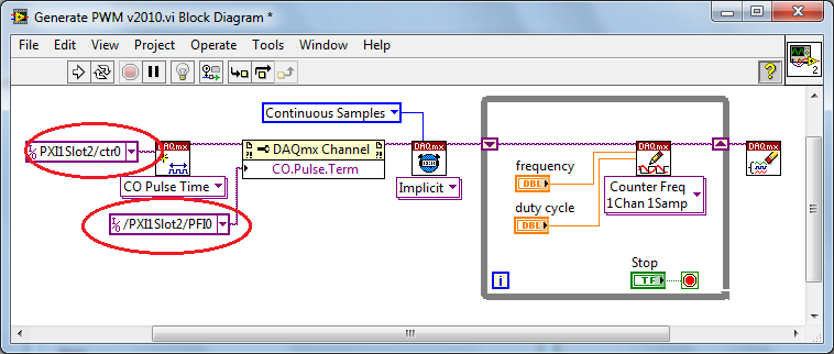

Before conneting to DC Motor, first make sure that the PWM is getting generated properly... use oscilloscope.
And have you changed the constant (physical terminals) for your device...??
Choose right terminal
Change it to:
Dev1/ctr0 & Dev1/PFI4 and the connection diagram should be:
Connection

I have modify my code according to your solution and have also changed the physical channels as recommended. I will inform you of the outcome soon..
I prefer changing the physical channel because NI gives such flexibility. Also I would like to mention here that, it is not stringently required to change the physical channels and that too to exactly 'Dev1/PFI4'. It can be any other available PFI line. Say if you don't want to use this property node (CO.Pulse.Terminal) then the default output terminal would have been the same (PFI4), but you can definitely choose any other terminal (check this link here).

Hi Again..
I did the changes as you recommended..and it works!! Awesome...Thank you very much..

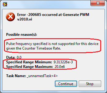

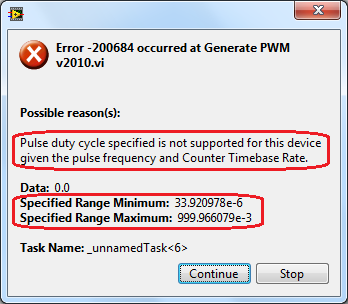

Just one last question...Duty cycle can be varied from 0-100%...But what about the frequency of the signal? Is there a limit for it??
What would be the best frequency to operate in?
Duty Cycle cannot be varied between 0-100% (or 0-1)...!! I don't remember this specification for all different devices, what I prefer is, I set the duty cycle to 0 (zero) and check the error message. Below is the error message from my simulated PCI-6251 card, I'm not sure if the max-min range is same for each and every DAQ device or is different.
Max & Min DutyCycle Supported (NI PCI-6251 Simulated)
Similarly for determining the max-min frequency, set the frequency to 0 (zero) and observe the error message.
Max & Min Freq Supported (NI PCI-6251 Simulated)
Regarding the best frequency to operate:
that is absolutely application dependent and also on the allowable max-min values (of frequency).
