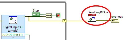

I also noticed there is no closing / resetting of the myRIO target. So we don't know what state your hardware is in when you try executing the code. Have a look at one of the myRIO examples (Help » Find Examples...), e.g. the one called "Edge Detection and Debouncing". You find it in the Example Finder at "Task » Toolkits and Modules » myRIO » Edge Detection and Debouncing.lvproj". There is a "Reset myRIO.vi" at the top right of the code. Feel free to use this as well (and also use the error handling as it is done here):
