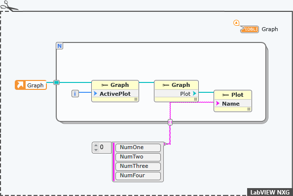

Accepted by topic author OA1
While properties in WebVI are generally missing right now the property "plot.name" exists already for GVI's:
Message 6 of 8
