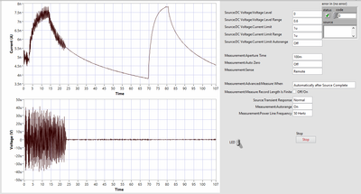

Here is an example. After 6 seconds, the noise starts. I didn't change anything in the setup/software.

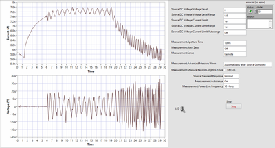

Here the signal starts noisy and suddenly became clean.

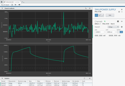

Using instrument studio, I don't see any noise.

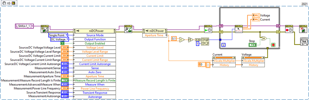

Here is the code of the above examples:
What could be the problem here?

To be clear, this happens only with your DUT (photosensitive device)?
InstrumentStudio settings are not the same as your code.
A few best practices,
  1. Disable measurement auto range
  2. Choose the smallest current range that works
  3. Try Local vs Remote sensing
  4. Set aperture time to #N PLC instead of seconds to ensure you eliminate power line noise
