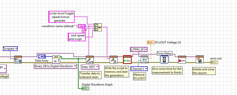

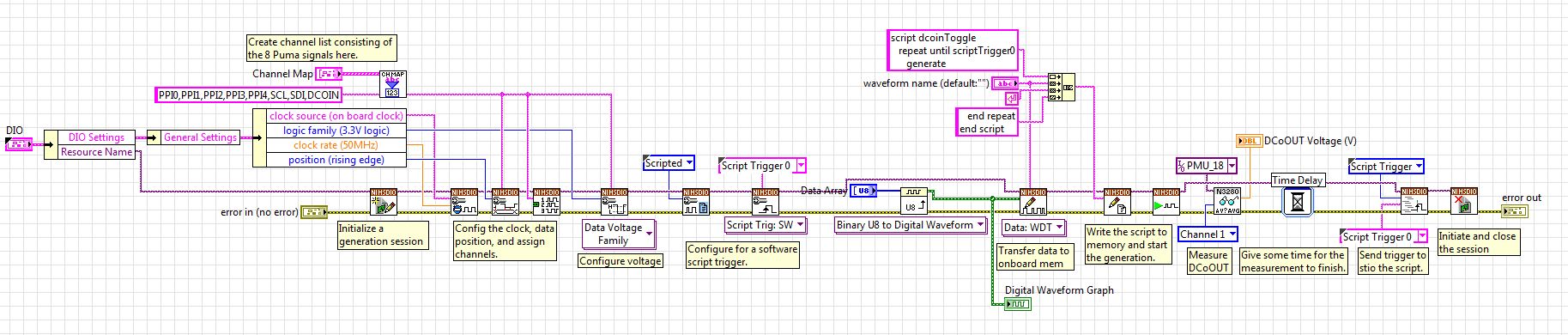

After some suggestions from colleagues I decided to try using a software script to generate the continous clock. I couldn't attach the VI so I've taken a screenshot of the block diagram and added it here -
The script to generate the continuous clock is very short -
script dcoinToggle
  repeat until scriptTrigger0
     generate myWfm
  end repeat
end script

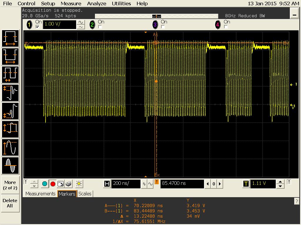

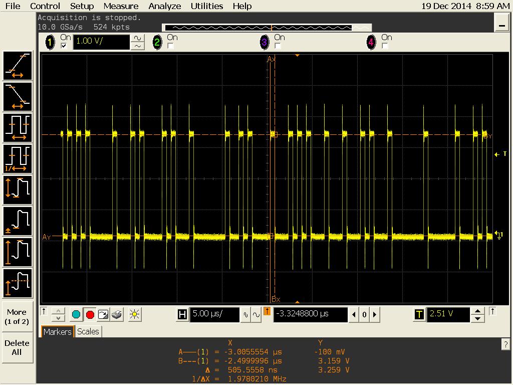

After the PMU measurement is made I send a software trigger to a previously configured trigger (Trigger0) to stop the script.  While this seems to work the clock is not running at a 50% duty cycle like I expected.  In fact the duty cycle constantly changes.  Here's what the screenshot of the clock signal looks like.  In this picture I'm only running at 2MHz just to prove out the concept.  You can see that the pulse width is 500ns (or 2MHz), but the duty cycle is not 50%.
Just curious if anybody has any ideas why I'm not getting a 50% duty cycle clock?  Have I missed something in the setup of the PXIe-6556?  Is the concept just wrong?

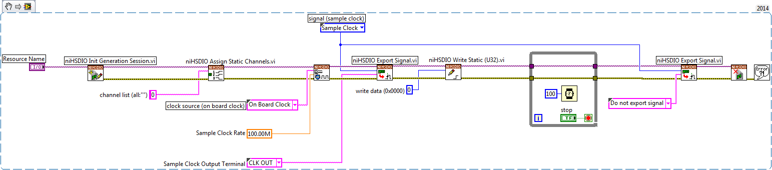

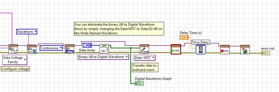

After some more research I'm going to investigate using the NIHSDIO Configure Generation Repeat VI to try to generate the continuous clock.  I would use the Abort VI after the DC measurement (not currently added) is made to stop the clock.  Here's the block diagram for this VI -
I have not tried this yet as I don't get tester time until later this week.  Any comments on this method?  Any obvious flaws that I have missed?  I have the same questions - Have I implemented the concept properly?  Is one method better than the other?

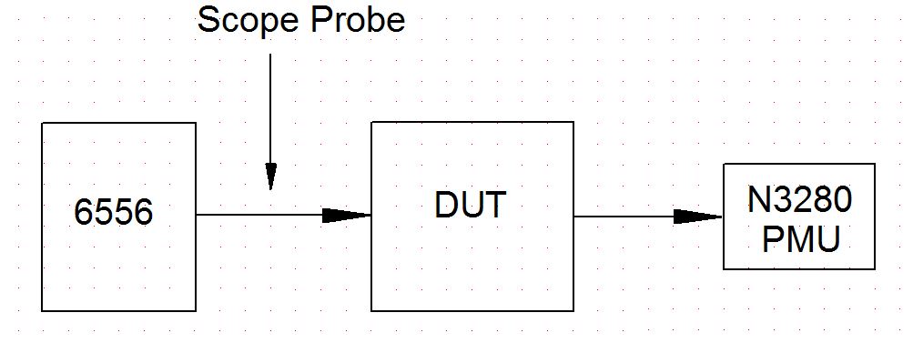

Thanks for the quick reply.  Since a picture is worth a thousand words, here's a simplified block diagram of what I'm trying to do.
I'm trying to use the 6556 to generate a clock to my DUT.  The clock provides a sample clock for measuring the duty cycle of a separate DUT system clock..  I am using the N3280 to measure the output from the DUT that will tell me what the duty cycle is.
The Scope Probe is where I captured the scope screenshot and is channel DIO8 from the 6556, and it goes directly into my DUT.  The goal is to produce a 100MHz clock from the 6556.  As you can see from the scope screenshot, it's sort of working, except that the duty cycle is wandering all over the place.I'm currently runnning the 6556 clock at 2MHz for debugging.

What data are you putting into your data array? Your output looks more like a bit stream then a signal with a varying duty cycle. If it were the duty cycle changing the pulse width would also change.

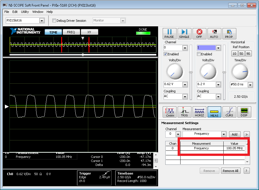

Here is a picture of what I tried. Using a static dummy task outputting a low signal on the data line, I created a 100 MHz clock signal on the CLK OUT terminal. I ran it on my PXIe 6556 and it did not show any errors or warnings but I did not have a scope available to check the clock signal.
I mainly asked for code to see what all the values were that you were writing to in the controls such as the data array. If you can give me that information for me to check then I can create your code on my end to see what happens for me.

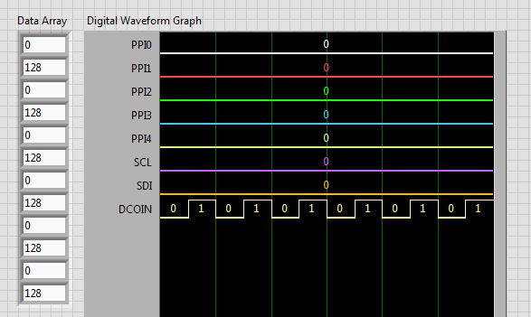

First to answer your question about what I'm putting in the data array.  The image below shows that.  What I'm trying to do is to have the DCOIN line drive be a clock signal to my DUT, while the other lines are held low.  The DCOIN line is channel DIO8 on the PXIe-6556.  Thus the alternating value of 128 in the data array.  I was using the 1D U8 version of the Write Named Waveform VI to produce these waveforms.

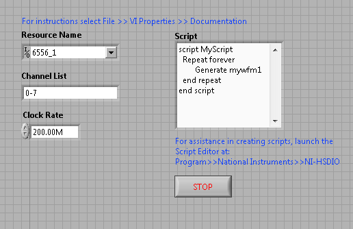

I have things working a couple of different ways now.  The first method is still using the scripting method, but I changed the script to be -
  script dcoinToggle                       //
     repeat forever                         // repeat loop runs until the system receives a Trigger0 signal
         generate dcoin_Clk             // generate the actual waveform named dcoin_Clk
     end repeat
  end script
and I got rid of the script trigger VIs.  The new block diagram looks like this -
I added the Abort VI to stop the DCOIN clock after the PMU measurement is made.  This works just the way I want, but I still don't understand why the original script using "repeat until scriptTrigger0" produces the non-50% duty cycle output.  And the image that I showed of the clock output isn't the best representation of what I am seeing.  From your perspective it does indeed look like a bit stream, but the pulse widths are really changing, randomly.  The non-50% clock did run until it received the software script Trigger0.  I suppose it could still be viewed as a bit stream, but with a random pattern of 1's and 0's.  I'd still don't understand why this method didn't work.

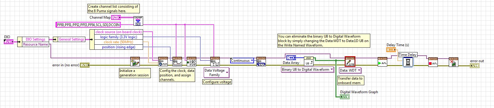

As I was poking around looking at some of the niHSDIO program examples I came across the Configure Generation Repeat VI and so I built up a VI using it.  The block diagram (without the PMU) looks like this -
This works exactly like I want as well, and is a little simpler than the scripting version.  So this is probably the version I will go with.  I still would like to understand why the original script version didn't work as expected.

I can get the correct output using a Scripted generation mode, but it has to be
script dcoinToggle
     end repeat
  end script
This actually works quite well.  The Scripted  version that didn't produce the desired output was
script dcoinToggle
     generate myWfm
  end repeat
end script
It did produce an output, but the output duty cycle randomly varied all over the place.  I'm curious as to what is the difference between the two scripts.  Whey did one work and not the other.

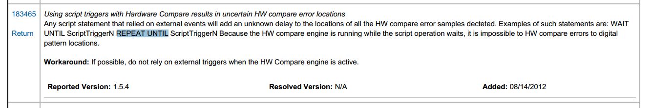

I did some digging and found out that it was a known issue in NI HSDIO 2.0. It was not fixed in NI HSDIO 14.0 (the next version) as far as I can tell. I looked at the readme for the NI HSDIO 14.0 Driver.
According to a known issue report:
https://www.ni.com/en/support/documentation/bugs/16/ni-hsdio-known-issues.html#183465_by_Date
This explains the image that you showed from you output with you scoped it. There was a random delay between all of the pulses. Using Repeat forever alleviates this error because it is not looking for any triggers.
