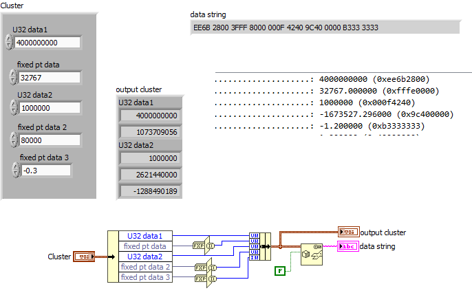

I'm using udp to transmit data and then observing the traffic with wireshark to make sure the message is transmitted correctly.
I have a cluster of data comprising different numeric data types which I flatten to string before transmission. The issue I'm having is that
the data shows up in the wrong field. The fixed point data field shows all zeros while the actual value appears in the u32 data field.
I've attached a screenshot of a sample message cluster and the wireshark screenshot. Any ideas what could be going here?

The data in your VI seems to be completely different than what you show in your wireshark capture.

A better test would be to look at the received string at the other end. flattened FXP data is always 8 bytes as you data string already shows. (Not sure why you are using FXP for a 15bit integer.).
It is useless for us to look at a highly truncated image of a wireshark capture. Is this the payload field? What were the cluster values for this particular capture?

Hi Altenbach,
Yes, the wireshark image is in the payload field. I was able to partially fix the problem and I could see the correct data in the first fixed point data field. I had to configure the fixed point control for 32 bit word length and 15bit integer length and then use the Fixed point to integer cast function to convert to unsigned integer before flattening to string. I repeated this process for the other fixed point data and configured the word length and integer lengths for the each specific fixed point control. The problem now is that the wireshark data does not match the input of the cluster for the other fixed point data except for the first one. I've attached a sample vi and the wireshark screenshot. Any suggestions are welcome. Thanks..
Looking at the hex values, only the first Fixed Point value is wrong.
None of your FXP numbers have a 15 bit integer length. (Some are unsigned 17:32, i.e. 15 bit fractional length), some are (signed 0:32, i.e. zero integer length)
You are really not making a lot of sense. First, can you configure wireshark to only show the raw hex data instead of trying to interpret it according to some rules. (Are you using any well known port so wireshark interprets it in terms of a certain packet communication format? That only confuses!)
Then also set your string to hex format in the VI and compare the two.
What is the reason for your fxp cast function? Unless you know what it did in terms of shifting, it's irreversible.
The smallest unit is a byte, so "15bits" needs to be padded to an integer multiple of  8bits, of course.
