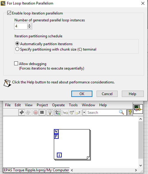

Hi KieranW,
For loops support iteration parallelism: right click on the loop edge and the option should be in the pop-up menu.  When enabled, you get an additional terminal on the loop as shown here.  I've never used this feature so can't really comment on any possible pitfalls but I'm sure other contributors can weigh in as necessary.
Andy

It's not the maths I'm struggling with. It was literally just the parallelism solved in the first response to this post. I was giving the summing of a 1D array as an example of why I needed to split the original 2D array into the constituent 1D arrays.
