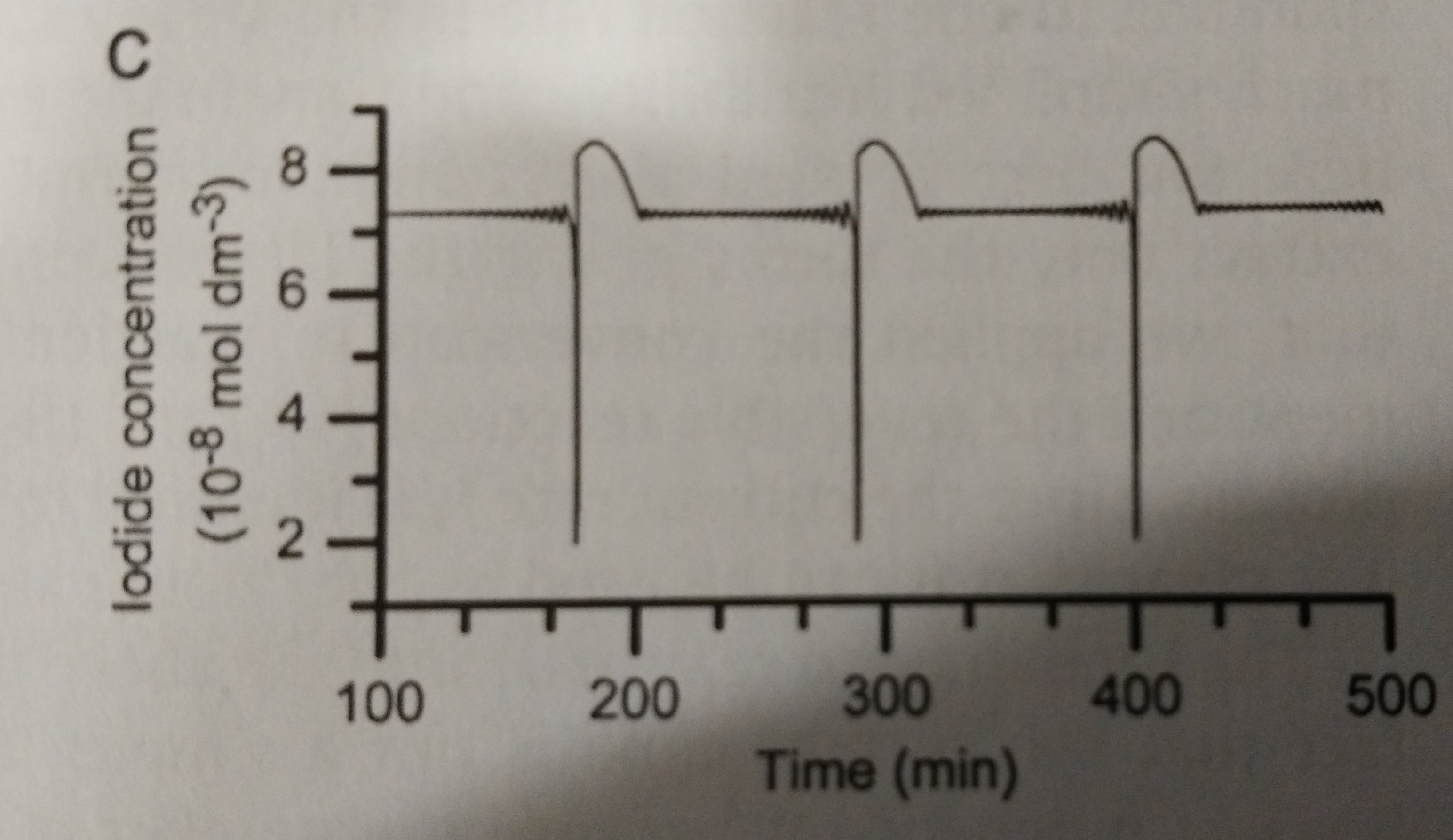

Indeed, the code runs with no error but I cannot reproduce the graph that I got with matlab. I was expecting the gear solver to work but it gives a weird signal. I think it is a problem in the solver parameters that I should define in advance.
