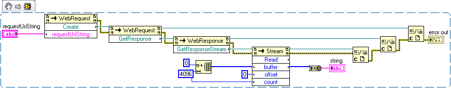

The class you want is System.Net.HttpWebRequest, and the programming is pretty simple. I wipped up a quick example below. Note that my reading portion is very primative - it's a fixed size array. You'll probaby want to "read until done" or similar actions.
Unfortunately, the ContentLength is usually not helpful as it's often -1. This means that the web server didn't send the length - it expects the client to "read until done".

Just in case someone stumbles on this thread, I've attached an extension to the .NET example shown by Lycangeek. This is a fairly quick web document fetcher (seems to be as fast as IE). There's probably a better way to do the proxy subsitution. That's required to prevent the first call from searching for a proxy (5 to 10 second delay).
The status code is a bitch sketchy right now as I'm searching for a .NET way to get this back using the WebRequest structure (Using .NET 2.0 here).
The image is big (sorry), so you may need to open up your browser window size to see it clearly. If you need help locating the .NET modules/assemblies, just let me know and I'll gather the list. You can likely find them faster searching http://msdn2.microsoft.com/en-us/library/aa139635.aspx for each method or property name.

Here is a VI snippet for those interested in working with this code:
Misha
