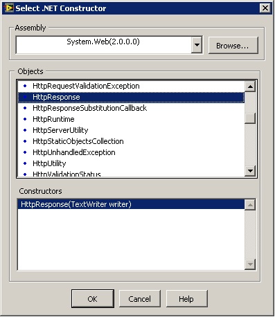

I want to download an xml document that has a https url, so this thread should really help me accomplish that. Unfortunately I can't even find the .NET assembly that contains the WebRequest methods. Anayone know which assembly I should choose in the Labview Class browser to find these methods?
BTW. the code snippet has the method nodes removed when I drag it into Labview. Maybe that means that the assembly is not present in my installation?

If you are trying to store the contents of the web page, you could use HttpResponse. I've not done the "Save As" ...
