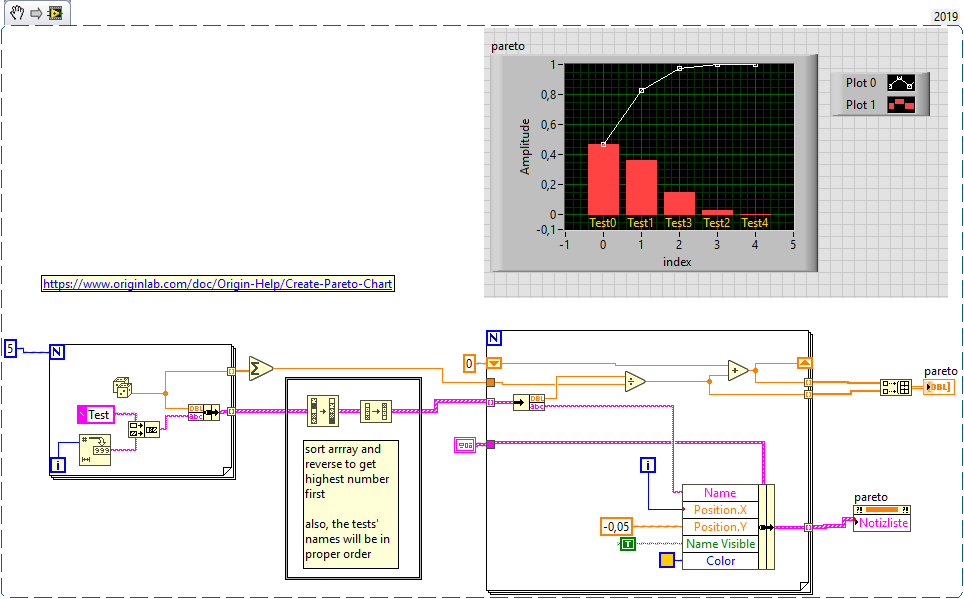

the tricky part will be to label each column properly
annotations may be used...
Message 5 of 10
(4,487 Views)
Hi Alexderjuengere
Could you please share your VI? Because I can not find Notizliste property node and I also don't know how to create it.
Message 6 of 10
(3,721 Views)
In English versions that is the Annotations property
Message 7 of 10
(3,708 Views)

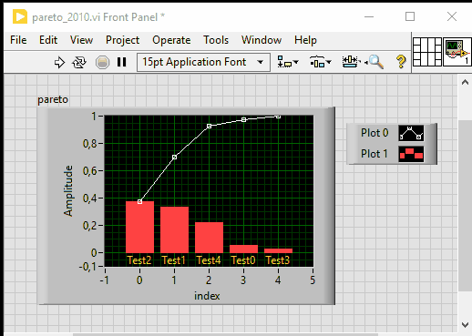

attached as.vi saved backed to  labview 2010 (64 bit)
correct

In case of single run, the annotations are clear and visible, but if the acquisition is continuous, then when maximum in Y axis data gets higher and then that compresses the Y scale values and the annotation gets overlapped with the bar plot data and gets hidden, any idea on how to handle this scenario?
Message 9 of 10
(664 Views)
scale your data to 1, before displaying in a pareto chart
