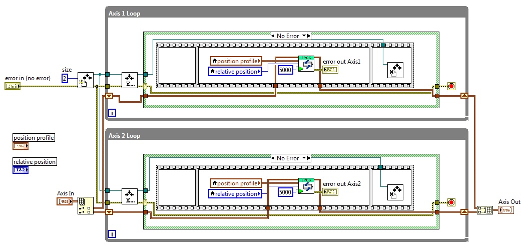

I realized the intial post could not work because it's in one loop. So I tried it this way... based on the simple Rendezvous example.  Without succes
NOTE:  The constant delay of "5000" should be on ZERO.  This makes it unblocking!!!   ...this way it workable...

Before trying to do all kinds of things you should consider one thing:
1) You have one serial connection. You cannot send two commands over this connection in parallel. So depending on your baudrate and the length of the command to start an axis you will have a certain delay between the two commands.
This delay will be at least:
             length of command in bytes  * 10 + some overhead
delay = ------------------------------------------------------------
                                            baudrate
So if the command is lets say two bytes "GO" plus termination character at 19200 baud you have at least 2 ms delay already simply from that. Add to that the uncertainety of the Windows OS which doesn't allow an application to guarantee execution of code to below ms accuracy plus the command interpreter in your motion driver and the potential delay could be in the order of several 10 ms.
So unless a difference of ~100ms is enough for your "at the same time", you simply can forget to get both axis started "at the same time" from software control only over the RS-232 port. You need to have some extra triggering facility, either through an external hardware signal that routes the start signal from one axis to the other, or through some software/hardware facility in your motion controller that allows to prepare both axis first and then start them with a single command!
