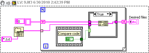

Feed your filenames array output from List File to a loop with indexing enabled.  Then for each filename, you have to parse out the date.  If it always starts at the same character position, you can use String Subset to get it out.  Or you could use Match Pattern, look for the fist letter character as a starting point.  Once you get the date, then you must compareit to the MM/DD/YYYY string.  This is the tricky part.  You need to compare the year first, then the month, then the date.  Send a boolean of the compare result to a case structure.  You will need to use a shift register initialized by an empty string array.  Inside the True case, use build array to add the filename to the output list (shift register contents).  In the False case, just wire the shfit register wire straight though.  The output will be a list of files you desire.

Extracting the date from the filename and comparing it to an input date seemed like a fun thing to write.  So I wrote a VI to do that.  Here it is.  Just wire in the filenames array and the desired date to compare.  The output is a list of files that are greater than or equal to the specified date.  You can change the compare function if you want something different.  The filename must have a 3-letter month followed by a space, followed by a date, another space, the year, a space then whatever else.  The compare date must be in the form mm/dd/yyyy.

This worked perfectly for my application.....Thanks tbob!
