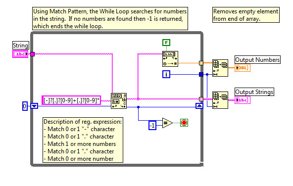

I'm trying to take a string of numbers that can be anywhere from -999999.999999 to +999999.99999 and separate them into two doubles. For example, if a user input -10000 - -10000, the two doubles would be -10000 and -10000. If the user input -10.11111 - +20.00111 it would come out -10.11111 and 20.00111. The "Extract Numbers" VI does the parsing perfectly, but I need a way to return the results into two doubles instead of an array of doubles. I also need the results to return all the digits past the decimal point for accuracy reasons. I'm using this code inside one of my states in a state machine and the driver I'm using only accepts doubles.
Attached is the code from the "Extract Numbers" VI.Thanks everyone!

Hi buickgn,
when your code works you only need to use IndexArray on the outputs. Otherwise you may try that one:

Thank you so much GerdW!!
