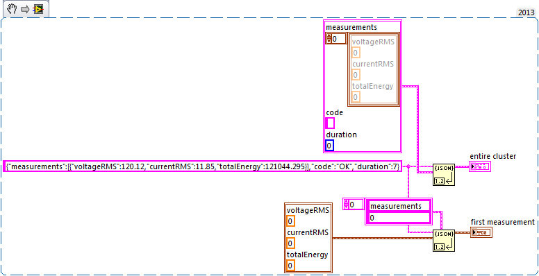

Even though you only have 1 item in the array, the 'measurements' field is a JSON array - denoted by square brackets. Remember - the cluster needs to match the structure of the JSON data you are trying to decode exactly (not the format you are hoping for!).
With Unflatten From JSON - you can either convert the entire JSON string, or you can pull out items individually by path (e.g. like an XPath in XML).
Here's a couple of examples:
In the top example - I unflatten the entire cluster and this will give an array of measurements. In the second example, I only pull out the "0th" element from the measurement array as a scalar. Had I not added the '0' into the path array, the data type / output would have been an array of measurements.
