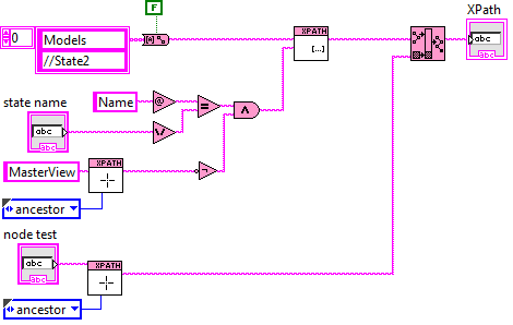

Be a little careful with XPath.  Some people have been known to wrap C++ libraries to have access to XPath 2.0 and an XSLT engine for awesome search and replace capabilities.  Others have been known to find ways to program XPath graphically:
