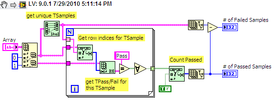

I had come up with this code but didn't post it because Jim beat me to the punch, and his code seemed more elegent.  There are so many ways to skin a cat (knife, razor blade, hatchet, axe, hydrocholric acid, etc...)

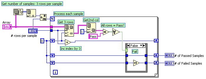

Sorry, I wasn't clear. I was wondering how your program can tell the difference. 😉

Here's a new approach.  It doesn't assume anything about the structure of the array.  The only assumptions are that each TSample will have the same name in each test and that a pass will be exactly "Pass".  The OpenG array tools make this much easier.  🙂
It can't.  But it doesn't matter.  One test failure or three test failures is still a failed unit.

@tbob wrote:
Yes, but three test failures could be anywhere from 1-3 failed units. Your new code is better. 😉

Altenbach, I think you were looking at Jim's code that I had just added some more code at the end.  Yes this code is wrong.  I modified it without thingking.  The code I last published is my code.  It accurately gives the correct number of passed samples.
I think we got crossed up with the latency in posting.  I posted at a time when you had already posted and I didn't see it, and vice versa.

Yes, one of these race conditions ....
My code is very similar to yours, just maybe a little tighter. 😉

@tbob wrote:
[...] It accurately gives the correct number of passed samples. [...}
Unless the rows per sample is not uniform, or if the array isn't properly sorted.
