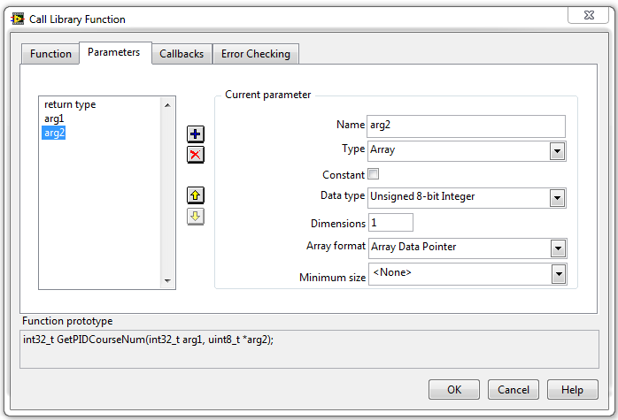

Here is my last attempt. I can't see why it doesn't work.
And here is the configuration of the Call Library Function Node:
(The first argumen ('1') is just the port number I'm using)
Any idea?

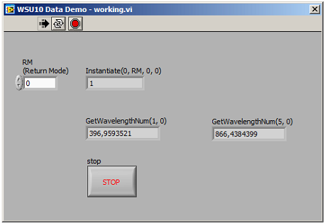

Attached you will find two VIs. In the working one I've been able to call other functions (getWavelengthNum functions) in the same DLL successfully, as you can see in this screenshot:
I have to say that I'm running these applications in a different computer to the one where I'm developing them, because I can't have LabVIEW installed in the computer where the Wavelength Meter is connected to. Therefore, I'm using Application Builder to create .exe files. Having said that, in the previous image you can see that it's working properly.

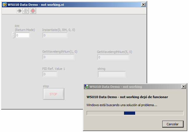

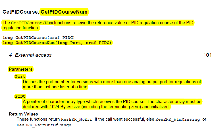

In the other VI file (not working one), I've just added another Call Library Function Node with the GetPIDCourseNum function. You can find this function in the attached manual (page 100). Here is an screenshot:
In the next screenshot you can see the error I get when I try to run this VI:

In the header file (wlmData.h, also attached), the function prototype is:
Data_API(long) GetPIDCourseNum(long Port, sref PIDC) ;

Check the calling convention. You have GetPIDCourseNum configured as "C" but the other working calls are configured as "stdcall" and the documentation says "All functions have to be declared with the library name ‘wlmData.dll’ and the ‘stdcall’ calling conventions" (page 115, section 4.1.7.4 LabVIEW).
EDIT: if that doesn't fix it, try setting the Error Checking level to "Maximum" in the Call Library Node configuration, and also try setting all calls to run in the user interface thread, or chain their error wires together so that only one call to the DLL executes at a time.
