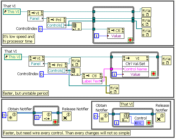

I have a question: how to pass variable to another panel?
I know 3 ways to do that.
1. Is too slow
2. is faster, but unstable speed and period
3. is hard to make changes.
Maybe there is another way to do that?

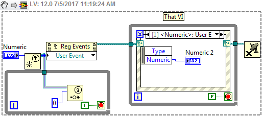

User events.

I also use User Events.  When combined with an Action Engine, it becomes very simple.

What is your definition of "variable" "pass" and "another panel". All the code you show acts on the same panel and the high CPU is probably due to the greedy loops.
Please explain in detail what you want to to and attach some actual code that demonstrates the question.

Thank you for that solushion.

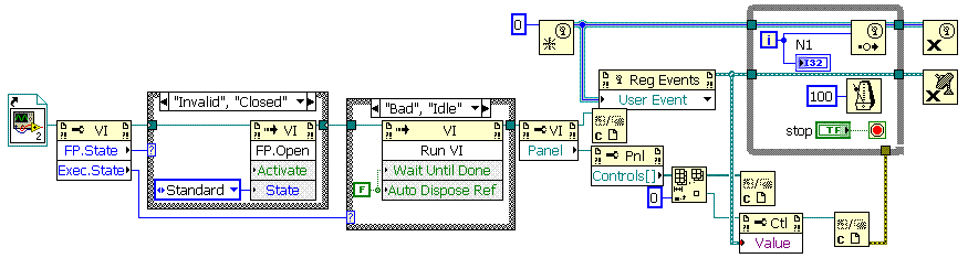

Example_VI_BD.pngI did try that. But user event have a queve. And under certain conditions (like stop and run target VI with indicators) information on the indicators will be lag behind.
Message 8 of 12
(6,616 Views)
I've found user events to be the most versatile and fastest to respond for transmitting data.  Many of the LabVIEW frameworks lean heavily on their usage.  If you are having issues with lag I would expect the design around the Event structure to be the problem unless you are really hammering that VI with TONS of user events and that doesn't seem likely in this instance.  Do you have an example where you indicators are lagging on the display VI using user events?

Hi. I make the example VIs.
Run the "1.vi"
stop and run the "2.vi'
and you'll see the difference between indicators "N1" and "N2".
