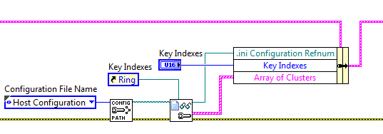

I'm 99% sure I'm correct on this but please could somebody confirm two things:
1. Its still not possible to directly pass out a ring via an indicator from a SubVI without loosing all the information. It has to be done via a control on the calling via and using a reference to update it
2. Once I have the control with the modified strings and values, its not possible to simply bundle the ring into a cluster constant (see picture below for both questions in pictorial form)
Cheers and thanks in advance
Mitch

Both correct, although it's not a matter of "still". This is by design - what you're passing is only the numeric value. All the other stuff is something which belongs with the ring control itself, not with the value.
If you want to have access to that data in your cluster, you could also bundle the ring reference into the cluster, but I would suggest not relying on FP controls to store your data - if that data is needed, you can add it to the cluster.

Hi tst,
Could you post a quick screen shot of exactly what you mean regarding getting the data into the cluster as I want to clarify I'm understanding you correctly. You said I could add the reference to the cluster but would recommend against this and your very last comment implied adding something else to the cluster other than the reference and doing it a different way?

No screenshot, but it depends on the data you want - if you want the list of strings and values, then you can add a 1D array of clusters and to your cluster and take the same data that you use to populate the ring.
