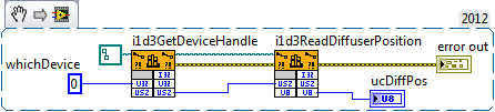

This snippet should be the correct Call Library Function Node for the Initialize and Read Diffuser functions. Give it a try? (If you're not familiar with snippets: this image is code. Drag it to your desktop to save a copy, then drag it into a block diagram. You'll need to fix the path to the DLL of course.)

It works but I am now confused as to why mine didn't work it is pretty much the way I had it except I configured the path in the call but that shouldn't make a difference.  I don't have the VI I started with since I have made changes.  The only thing I may have had different is that in the getDeviceHandle I think I had the handle param set to adapt to type then wired to a I64 constant, but I tried this and it still works.  Oh well got lots of practice writing DLL's though.  How did you create that snippet?  Do you drag the code into a picture editor and save as a png file?

[...]  How did you create that snippet?  Do you drag the code into a picture editor and save as a png file?
Just select the code you want to have in the snippet and select Edit >> Create VI Snippet from Selection.
