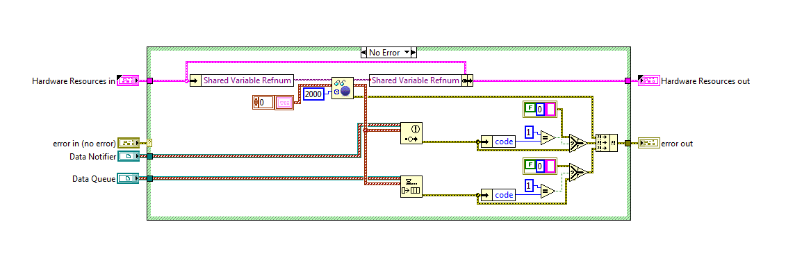

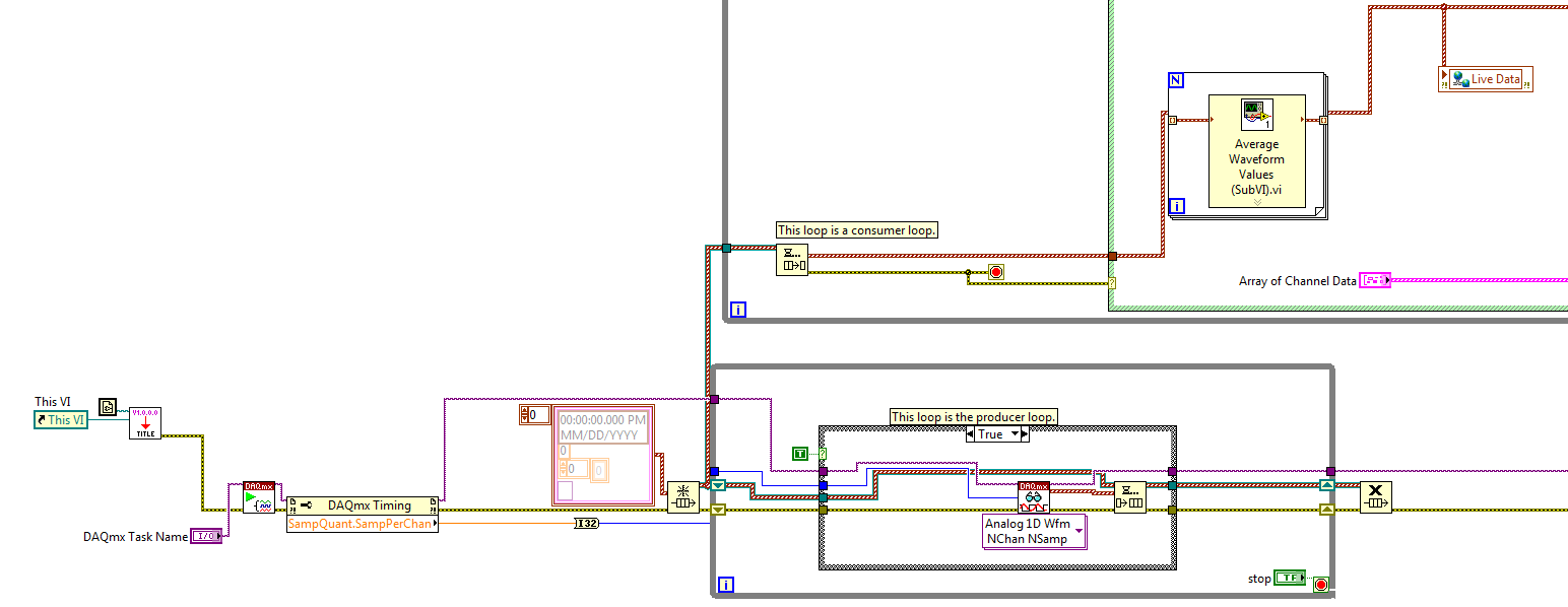

Here is one of my examples.  Here is a segment of code that shows a producer loop sending data to a consumer loop through a queue (the queue's data type is a 1D array of waveforms).  Part of my consumer loop outputs the data to a Shared Network Variable called "Live Data".
Here is an example of a seperate application that can consume this Live Data (from this app...or..any app).  This example is a segment of some code that consumes the Shared Variable, passes the data to other parts of my application (a notifier and a queue), and my other parts of this application consume that data to perform some control operation.  This is actually modified from the "Continuous Measurement Application" template (a very powerful template, btw).
Anyway... Notifiers, Queues, Shared Variables... very powerful things to have in your knowledgebase for LabVIEW.  I suggest learning them as they will add more flexibility to your projects.
