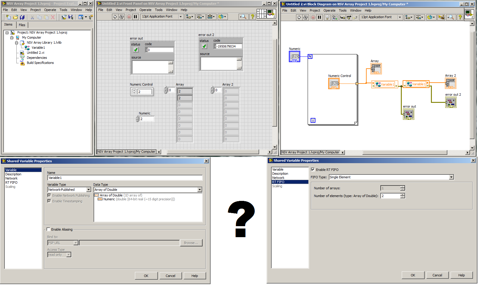

Passing an array through a single element RT FIFO Network Shared Variable, Error Code -1950679034
This should be simple.  I'm just passing an array through a single element RT FIFO Network Shared Variable.  And yet I get nothing.  How could this not work?  What is this Error?
(3,163 Views)
Accepted by topic author Chon.Mech
Well... it must have been some kind of timing thing because, adding a 100ms wait fixed it right up.
Now don't I feel silly Smiley Frustrated
