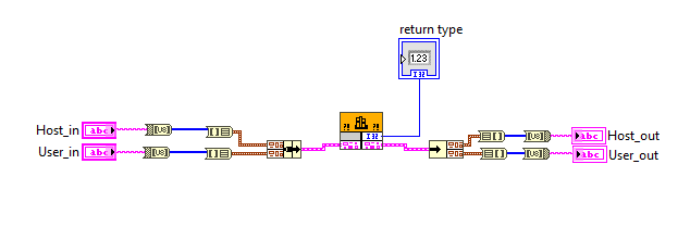

In the dll function I've putted a sub function to dump the struct pointer content to a file.
in the dumped file I found the content of the fist char variable only.
My VI is
I've done this to study about labview memory system, but like you sayed I'm thinking to pass the main param as a filepatch to the file with the "static" MySQL config. Or pass a string with "\n" between the parameters to be interpreted this on dll.

What do you think is this declaration doing?
typedef struct {
   char *host[128];
   char *user[128];
} *pconn;
Maybe, just maybe, it would start to behave a little more like what you expect when you change it to:
typedef struct {
   char host[128];
   char user[128];
} *pconn;
Take a minute and think good and then tell me why it didn't work the way you wanted.
But look at your resulting diagram. Is this really worth all the hassle? This code is much less runtime performant than if you pass the strings as individual parameters to the function. In addition it is a dragon of code to maintain later. Most beginners in software always forget that code they write now is not going to be ever finished. Somewhere in the future, someone will be required to make modification to that software, and if it is you, you will wonder how you ever could write such code, and if it is someone else he or she is going to curse you for this. Smiley Very Happy

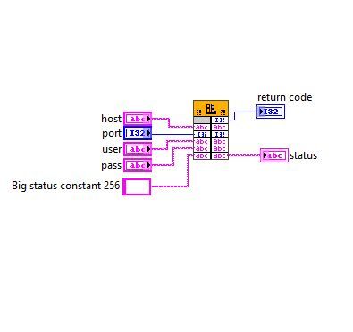

You are right! I’ll pass string by string and make a subVI to hold all the wires. I’m spending to much time trying to figure out something that is not the project’s goal!
Thanks for you opinion, some times the solution aren’t just coding but a more effective approach!!
(3,901 Views)
Just to put the solution here to collaborate with future users.
So, here the solution..
As @rolfk sayed, the best solution is forget to pass the struct stuff to DLL.
I passed string by string, and created a internal functions to convert it to c_string (just add the null char at end of each string).

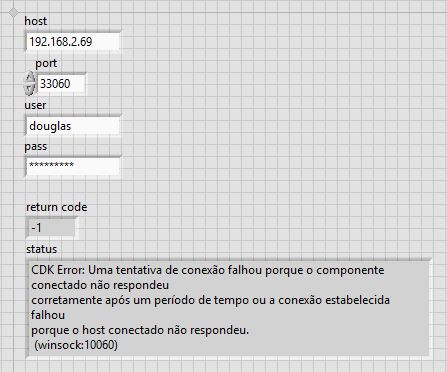

How we can see, was necessary to pass a big string to labview to pre-alocate the memory (using malloc crashs everything, using a shorter string than returned string,  works but crashes the labview when I tryed to save the VI).
