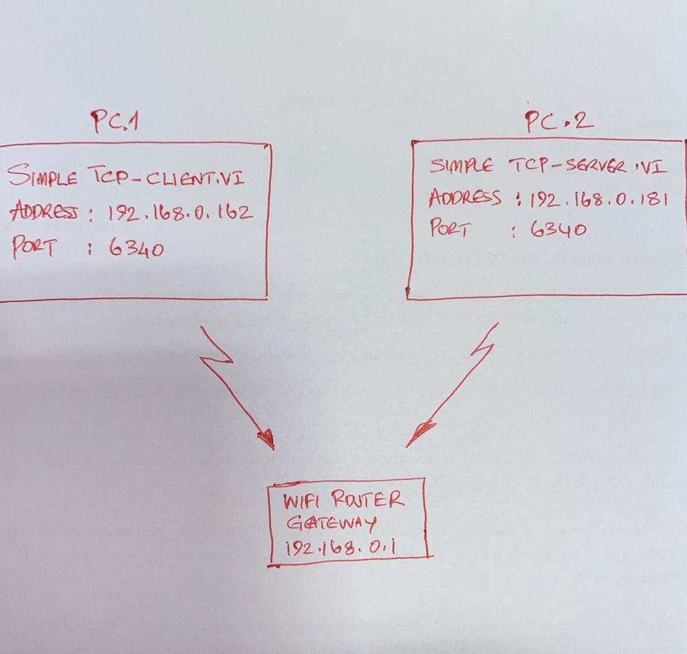

Been trying the Simple TCP-Client.VI.
The setup is shown below. PC1 is the Client and PC2 is the Server.  They are on the same local Wireless network.
In the example I just entered the IP address of PC2 in the Client code and that of PC1 in the Server code ... the sketch makes it clear.
When I try to run both, after a long time ( based on time out ) communication just starts and then stops with a time out error.
Am I doing anything wrong ?
Raghunathan
LabVIEW to Automate Hydraulic Test rigs.
(5,480 Views)
Either you are "doing something wrong" or one of your PC's Networking isn't configured the way you think it is.
I don't use the Simple TCP Server-Client setup, myself, but I just tried it out from the LabVIEW 2019 examples.  I first ran it on one PC, noting that the Client (by default) "points to" the Server running on "Local Host", namely the same PC as is running the Client.  So I started the Server, saw nothing exciting, started the Client, and the Server started showing me a noisy waveform (because the Server was generating Random Numbers).  When I stopped the Client, the Server stopped.
OK, so I fortunately had a second PC available running LabVIEW.  I opened the same example on PC-2 and opened the Client.  I noticed that the Server didn't need to know the Client's IP, but the Client needed to know the Server's, so I found it (192.168.1.xxx) and copied it (as a string) into the box that formerly said "localhost".  Ran Server, started Client on second PC, and saw a noisy graph on both.
So the Example (in my hands) works as advertised.  The only change I made was to put the IP address of the Server into the "address" string of Simple TCP - Client.vi running on the Client, start the Server, and within 30 seconds, start the Client.
