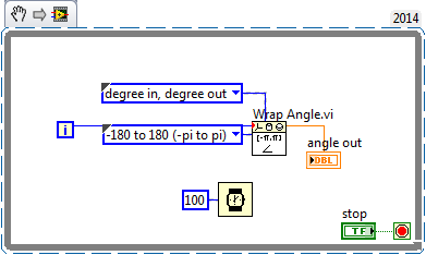

There is a vi call Wrap Angle.vi in the Mathematics ->  Geometry  -> Angle palette that does that.
