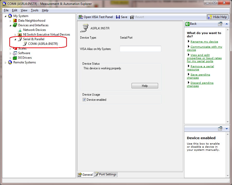

Well, I'll give you an example using my workstation here.  I have COM4 on my computer for RS232 (a USB-to-RS232 dongle is connected to one of the USB ports). I can open that port using VISA_Open.vi in the following example C code (VB.NET would be similar, just needs different syntax):

In the above C example, I got "COM4" from NI MAX (image attached) on my computer. The above call opens a VISA reference and keeps it in the DLL, you don't have to send any references back and forth.
Hope this clarifies...
